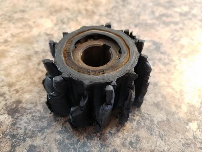

            Thanks for all the great responses! So I finally got around to changing the impeller. Attached is a photo of the old one... yikes! I'm learning on the fly here...from what I'm reading - when an impeller is in that bad of shape, some people seem to suggest basically tearing everything apart to try and find the missing pieces. Others seem to say that if the engine isn't overheating, then don't worry about it. Being that its March in MN, I really won't be able to start the engine and check for overheating for another 1-2 months. I checked a couple of the easier spots that were suggested - the transmission oil cooler and the thermostat. And a couple hoses in between. Didn't find anything. I have no idea when the last impeller change was. Is it possible these rubber pieces might not be an issue? I just don't want it driving me crazy for the next 2 months. Also, when checking the thermostat for pieces - it looked te be original. The gasket was basically non-existent at this point. It looks like a thermostat is only a $30 part - should I just swap it out as long as I'm replacing a bunch of other stuff? And is a thermostat swap as simple as taking out the old/installing the new? I don't know the typical lifespan of a thermostat. Again, thanks everyone!

              Wow that impeller is rough no doubt. I'm assuming you have a GT 40 engine and if so changing the thermostat and gasket is easy.. For piece of mind go on an change the thermostat; a cheap part to replace.
