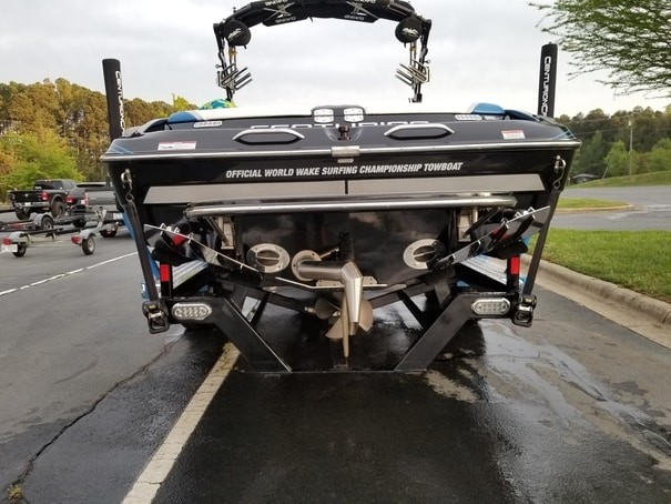

          I added Fresh Air exhaust to my boat, not only does it quite down the boat a LOT, but is like having a stereo upgrade for the surfer since you do not have the exhaust pointed at you, so you can hear stereo and talk to people in boat much easier. (1st pic below shows the FAE on my boat).

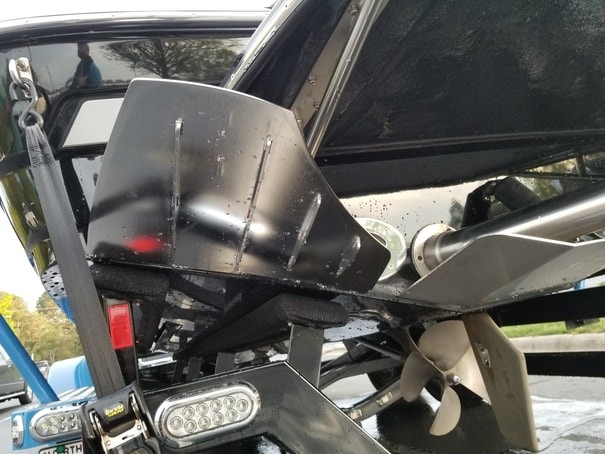

          I actually installed a new InfinityWave surf tab system on my boat about 2 weeks ago so I no longer use my Nauticurl suck gate. Dont get me wrong, the Nauticurl and many other suck gates including ones that you can easily make yourself work excellent! InfinityWave Mfg wake surf shop.... is a newer company that is making these surf tabs and I am STOKED I pulled the trigger and did it. My wave with these new surf tabs is excellent with tons of push. I finished my install on 04/13 and just got to lake test it this past week on 04/17. GSA (or "Go Surf Assist") is another after market surf tab system (Wakemakers also sells this system, they called it "Wave Control" previously since they used their own electronics but believe that starting this year they decided to use the entire GSA system since they didnt have the staff to support their own system). GSA has been out for a while and works excellent on many boats (in fact my buddy has had it on his 2006 Malibu 247 for 3yrs) but their system costs $4k so even tho I have wanted to do this upgrade to my 2014 for a while, I could not bring myself to spend that kind of money.
          This new InfinityWave Mfg surf tab system is only $1,800 and I can say without any doubt now that it WORKS GREAT and was worth every penny.
          Here are a couple pics taken of the InfinityWave surf tabs mounted to my boat and the wave it put out, all 4 pics taken on 04/17 when I did my first lake test.
