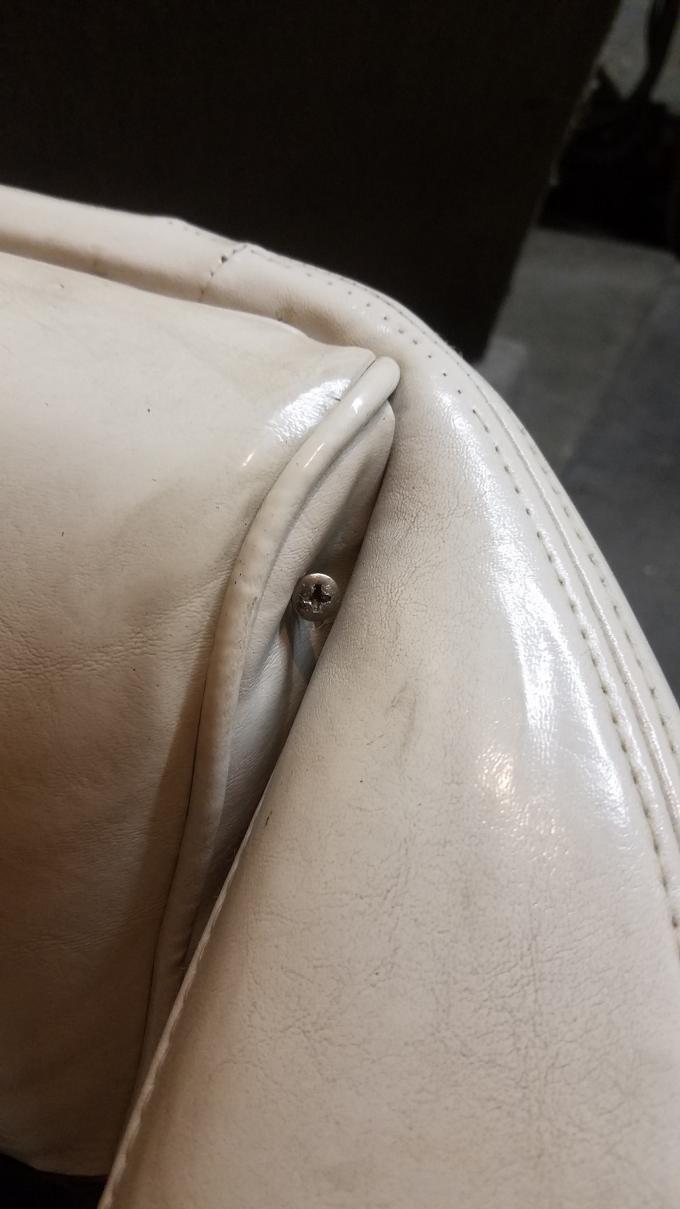

    I'm re-upholstering the driver's seat of my 2001 Super Air and was checking on how to remove the backrest without damaging anything. It looks like it should just pull up but wanted to check before I screw something up. Thanks

      I believe I already responded to your Facebook post, but in case there are two of you out there with this same question...yes it pulls straight up, but there should be a screw or two on the edges of the back rest. Open the crease and you should see Phillips head screw.

        Here is a picture of where mine is on a 2000 SAN. There was a small whole in the vinyl. Just had to dig the Philips head screwdriver around to find it.
