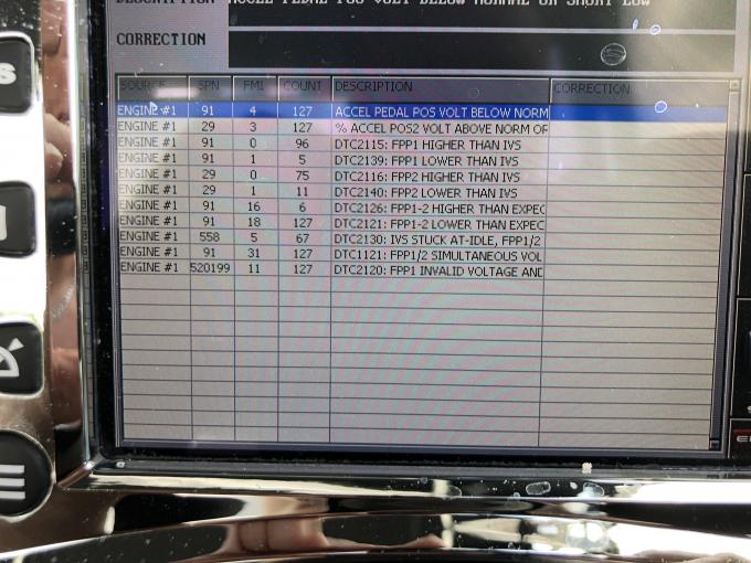

    Im limping on the lake right now due to these codes. Anyone out there can call me if you can help reset/bypass them? (708)935-3843. I have idle speed only-no throttle control

      Turns out the TPS sensor went bad. Took it to the shop and they replaced the potentiometer...problem solved!
