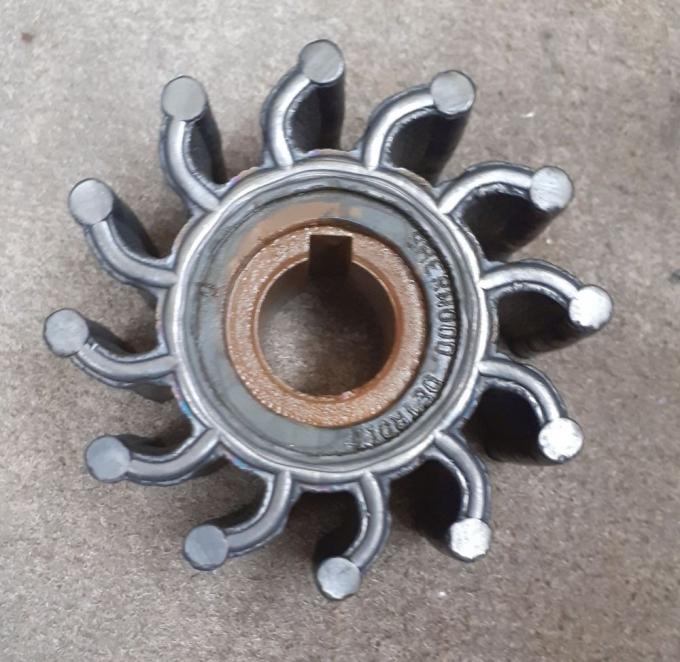

        It's definitely the exhaust hoses burning and smelling. Odd since engine temp stays fine!
        Changed impeller (still looked like new), and port side is better now, starboard is still too hot to touch (not even 1 sec) and keeps burning.

            Well the impeller wasn't damaged at all, so that's not what's causing it, but yeah it's clogged somewhere. Rust probably.
