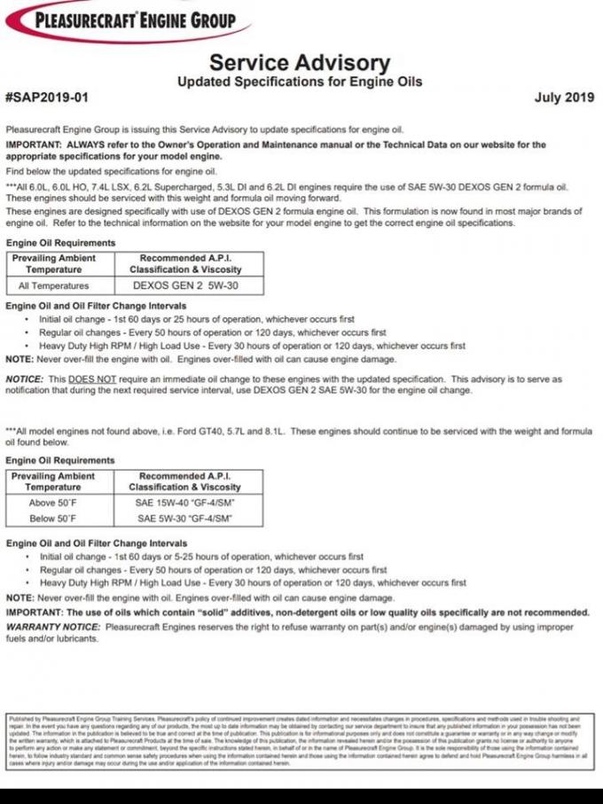

We bought a 2015 Ski Nautique team 200 about a month ago, now we have the dock finished I want to service the boat and get it in the water, I heard PCM has been having issues with older 5.3 liter engines at around the 500 hour point, and guess what we are sitting right at 500 hours. From what I understand the problem is with the oil PCM was recommending in older engines, causing engine seizing. PCM is supposed to have come out with a service bulletin (or whatever they call it) that describes the problem and recommends a different oil and I'm not sure if that it included a different oil filter or not. Can anyone here tell me if this is true and what oil PCM now recommends and the filter also if that was included in the bulletin. I tried searching the internet to see if I could find anything on this and didn't have any luck,I called the dealer but the service manager was to busy with paying customers to return my call, any help on this would be appreciated because I sure don't want a seized motor even though from what I understand PCM is being great about replacing engines that have problems associated with this. Thanks.

I have not heard about a Service Bulletin about this (that doesn't mean there isn't one though).
Their oil recommendation hasn't changed, at least through the 2018 manuals.
Here are my thoughts, which I have posted before, about their oil recommendations.
Below is the chart showing oil requirements.
Rotella 15W40 does not meet the GF-4 (or new GF-5) requirements.
Good luck finding an oil that does, and is SM rated as well. It is not easy.
In fact, based on this information from Wikipedia, I believe PCM may have made a mistake in their requirements, since according to this, GF-4 doesn't apply to the 15W-40 weight. Also, since GF-4 was eliminated in 2011, it would be impossible to find today. It has been replaced by GF-5.

Thanks Jeff for looking into this further. I spoke with the service managers at the Nautique dealer and Centurion dealer in Mesa AZ and neither one of them had heard of any service bulletin on using a different oil, but I see it only came out in July so, they probably have it in a backlog of email or something and haven't read it yet. The only thing the Centurion service manager says they recommend is, going from 15W-40 to 25W 40 when temps go over 100. This makes no sense to me unless they feel the thicker winter rating will cling to cold engine parts better when outside temps are high, when the engine is first started. But again why would he recommend that when PCM is recommending going the opposite way with a 5W- 30 and using it for all temps. I looked at a few oil charts because quite frankly that 5W-30 recommendation scared me in the Temps we see here. But looking at the viscosity charts 5W-30, 15W-40, 25W 40 all should be fine. Oils and greases you really need to do your research there is so much misinformation out there and so many armchair experts. Heres another odd thing I noticed PCM didn't list the 5.7 in this bulletin, you would think it would apply across the whole GM range. Thanks again Jeff.
Actually, the 5.7 is mentioned near the bottom where they talk about engines that should continue to use the old recommendation (which again, I don't think exists!).I own and operate Silver Cove Marine, which is an inboard boat restoration, service, and sales facility located in Mooresville, North Carolina. We specializes in Nautiques and Correct Crafts, and also provide general service for Nautiques fifteen years old and older.
I was wrong the motor in our boat is a 2014 5.7liter CES EX-343, I misunderstood my son in law when I asked him the motor size and I discovered the mistake the other day when I was checking the engine ID tag. So it looks like I can stick with the 15W-40 oil according to the service bulletin, but now comes the fun part of finding 15W-40 that will work since Rotella doesn't mention that it can be used in gas engines anymore.
Rotella is what many people use in that engine.
You will not find anything that matches the recommendations from PCM. I maintain that this was a mistake on PCM's part when they wrote these recommendations. The GF-4/SM designation does not apply to the 15W-40 weight, and GF-4 was eliminated in 2011 and replaced with GF-5. See my other post at the top of this thread.
All you can do is use the next closest thing, which many people feel is Rotella 15W-40.
If you find something that DOES meet PCM's requirements, PLEASE let me know!I own and operate Silver Cove Marine, which is an inboard boat restoration, service, and sales facility located in Mooresville, North Carolina. We specializes in Nautiques and Correct Crafts, and also provide general service for Nautiques fifteen years old and older.

My last post was for the 5.7 guys. Since I recently purchased a 2015 SN200 ZR409 I will switch over to this stuff on my next change:
https://www.pennzoil.com/en_ca/products/full-synthetic-motor-oils/pennzoil-platinum/_jcr_content/par/productDetails.stream/1525707084264/470d87597ee1e0e5d72d908f697bc49afba7fd8e/PNZ_API_Plat_5W30.pdf
keep in mind dexos 1 gen 2 is different than dexos 2, at least that is the conclusion I have come to.
