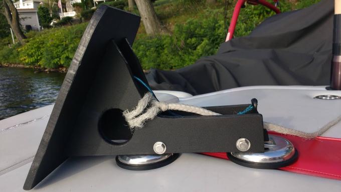

    My DIY shaper board is 10" wide , 12" long and I believe I built at a 60 degree angle:
