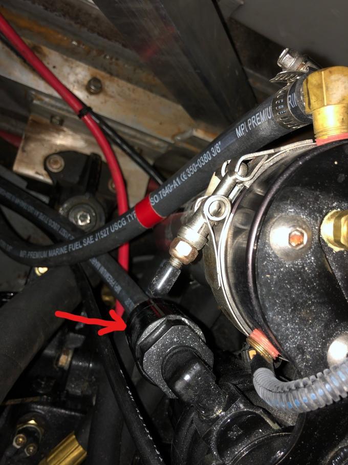

    Click image for larger version  Name:	InkedIMG_6718_LI.jpg Views:	0 Size:	88.7 KB ID:	592882 Does it have this little canister right here before the FCC? There is a little screen inside of it that could be clogged. You can change it out or wash it out.

        I believe that is canister in photo is there I will look inside of it and see if the screen is clogged... I thought the line in the photo with the red band was the fuel delivery hose though...
