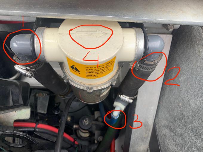

    Hey guys, I am planning to do boat maintenance myself for the first time and need a solid plan for running the boat on the trailer. I think I am going to use the "bucket method" and need to make sure I understand raw water cooling mechanism on my PCM GT40 and make the right connections
    I narrowed it down to 2 options:
    1. Buy Bucket Hose Adapter and connect it to the hose exiting raw water strainer (marked #2 on the pic)
    or
    2. Buy 1.25" PVC Hose and connect it to the elbow connector entering raw water strainer (marked #1)
    Option #2 is a bit cheaper and I can get longer hose to allow the bucket to stand on the ground. With option #1 the hose is not long enough and I would have to put the bucket somewhere on the boat. With option #1 the water will be bypassing the water strainer, is that ok?
    Just to make sure I understand the cooling mechanism, the arrow on the water strainer (#4) shows direction of the water flow - hose attached to #1 is coming from thru hull fitting, and hose #2 is going to transmission cooler-->water pump-->engine. Am I right or wrong here?
    Also, what is that small blue hose marked #3 on the picture and where it's going?

    Not sure what number 3 is. Do you happen to have the shower option on your boat? Might be the cold water connection for that.
      Yes that's it, I do have cold/hot shower.
