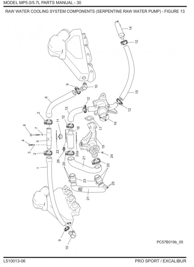

If the thermostat is stuck open, your engine may never be warming up, causing the gauge to appear to not work. Try a new thermostat first, and if that doesn't fix it, move on to the temperature sensor.
Part 11 below is the thermostat if you have an Excalibur.
Part 23 below is the thermostat housing if you have a ZR6.
