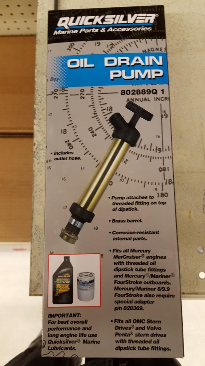

    Ok, I did the oil change myself with a pump, and pulled the oil through the dip stick holder. I originally planned to use the drain, but where would you drain to, this hose would not reach the drain plug. What did I miss?

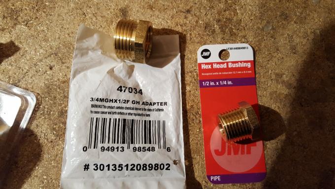

    You will get many different answers to your question . I have the exact same drain hose set up as you . I took my pump and attached a brass fitting to match the drain hose base fitting on drain hose . Take that female brass drain cap to Lowe's and match up and you will be in business . No mess and I could not be happier with the results during my oil changes

        Here is what i use.

              Evening Shade’s method works just fine . The only fitting you would need to buy would be the female brass fitting to place on the pump hose . Approx cost $3.50. This method is much cleaner with less mess than inserting the extractor hose into the oil pan drain hose. I have tried both methods . As Jeff said it is the only way to go .

                      So, the option of putting the pump hose down the drain hose did NOT work for me. I was never able to get a good seal for the pump to get proper suction. that might be a problem with the pump I was using.
                      Greatly appreciate the guidance on not putting the pump hose down the dip stick, due to the tendency to get stuck. I had no issue, but maybe I was lucky.

                            Agree, doesn't make sense. I must have pumped for an hour or so, only to get about 1/2 a quart. I was desperate to finish, so I put the hose down the dip stick tube, and immediately started getting oil, and got the full 5 quarts expected after about 30 minutes pumping occasionally. The pump I use was designed to go into the dip stick tube. Even still, I was not a fan of that approach, hence the reason I posted. I was on a hill, and so that might have been an issue, and if I got 4 qts instead of 5, that would make sense as to the problem. And just in case you are asking, yes, I ran the engine warming up the oil prior to extraction.
