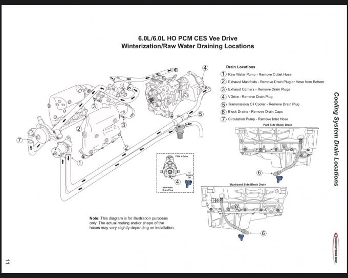

This is my first winter with the 2019 Nautique 230. So, getting to know the PCM ZR4 6.0. I was able to drain 5/7 areas, according to the manual (attached). I’m having trouble with items:
#1 Removing inlet hose from raw water pump
#5 Removing drain plug from transmission oil cooler

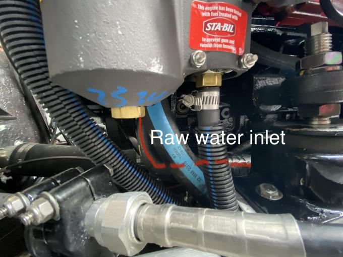

The raw water pump is shoved way back and under the rear of the engine (stern), I don’t see how I can possibly get access back there without pulling a bunch of stuff off the back of the motor. I can barely feel for the hose clamp let alone loosen it and pull the hose (and put it back!)
The transmission oil cooler doesn’t appear to have a drain plug. I’m guessing removing the inlet connection will suffice? Or am I overlooking something?
