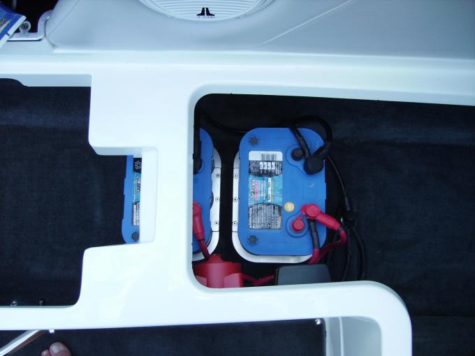

    If anyone is looking to upgrade their existing lead acid battery with a AGM type battery here is what I know. I replaced my two Interstate group size 24 lead acid batteries with two Optima AGM batteries with group size 34m. For some reason these Optima batteries have a goofy sizing vs lead acid batteries. My lead acid batteries run about $128.00 retail vs the AGM Optima at $237 after core recovery and discounts from Advance Auto. The Optima size 34 M will fit into my existing battery box sized for a lead acid group size 24 battery. It is a bit lower in the battery case therefore I placed a 2 x 6 piece of wood in the bottom of the battery box to bring the terminal posts to the same height as the original battery in my 2017 G23. From what I have researched these AGM batteries hold their charge longer and the life of the battery is suppose to be longer than lead acid batteries. In addition they are suppose to preform better at cranking when the boat has been out of use for an extended period of time. This is a cranking AGM battery vs a deep cell type. Both the Interstate and the Optima have 800 CCA. I will report back later as to their performance and reliability.
    Click image for larger version  Name:	=AMG 1 (2).JPG Views:	0 Size:	55.3 KB ID:	601360Click image for larger version  Name:	=AMG 1 (1).JPG Views:	0 Size:	56.2 KB ID:	601361Click image for larger version  Name:	in.jpg Views:	0 Size:	55.2 KB ID:	601362

    Nothing weird about optima's group sizing at all. You swapped a 24 for a 34. Those group numbers have a direct correlation to the battery's physical size. They are supposed to be different. A group 34 is roughly 10L x 7W x 8H. A group 24 is right at an inch taller. Does not matter if its an AGM or LAWC.
    • GMLIII
      • May 2013
      • 2797
      Thanks for pointing that out. Bottomline I could not find a size 24 in AGM in Optima therefore I had to adjust my battery box to fit the size 34. The 2 x 6 piece of wood in the bottom brought the battery to the ideal height in the box.
      In addtion MLA could you explain in my situation why a lower group size = a larger size battery. .
      Optima AMG group size 34 M is smaller in size then the Interstate group size 24MS. Most folks would think just the opposite like me.

                GMLIII
                Optima does not offer a G-24 AGM, but Trojan and West Marine do.
                The BCI (battery Council International) group numbers are for selecting the right size, in physical dimensions, for the application, They do not necessarily reflect any performance specs as compared to other group sizes with a higher or lower number. The BCI group numbers may be chronological as to what common sized where on the market when the BCI standards where implemented and what sizes came later in the industry.
                Also, if your G has the factory on-board charger, you need to change the charge profile plug over to AGM. These will help them last. Even then, optima only recommends their charger for charging them.
