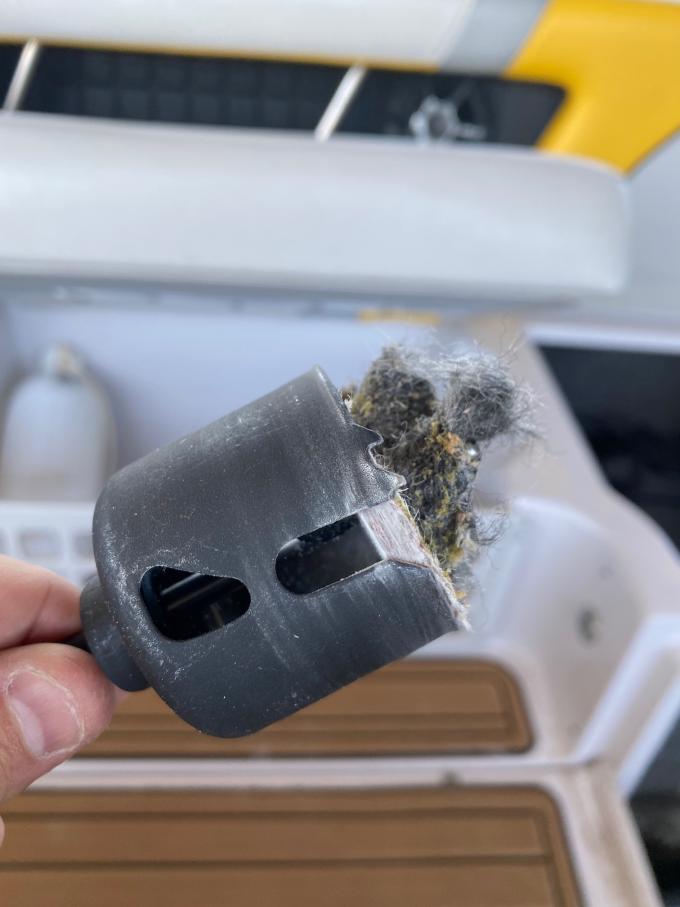

            Got the charger installed. Thanks for the help guys. Took longer than it should have, and taking a hole saw to the boat was a bit nerve wracking, but I'm happy with how it turned out.

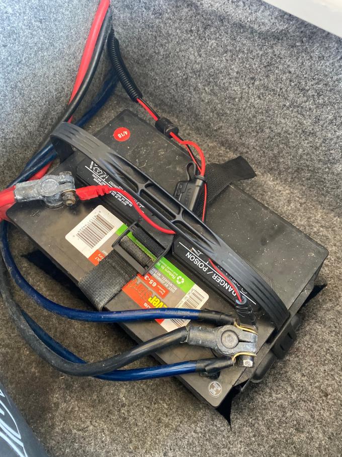

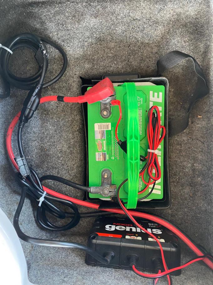

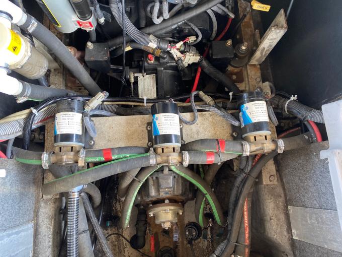

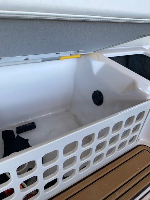

                  Sure guys, here's some various pics. The charger is in the starboard aft locker behind the cooler storage care. I mounted the port inside the cooler area. On my dock, there is an outlet right there, which was a big part of the location decision.
                  The charger is screwed into the side bulkhead, which separates that compartment from engine compartment.
                  In the pics going across the engine compartment, you can follow the run by looking for the white zip ties. There was just enough space to push the cables through without having to cut anything.
                  Not a lot of extra cable going to the port battery, but I think it will be ok. It seems all snug and secure.

                    Thanks for posting pictures . As you mentioned , I installed my charging outlet on the Port side simply because that is where my electricity is on my dock vs Starboard side . I think many install the charging outlet port placement without this consideration which is a mistake.
