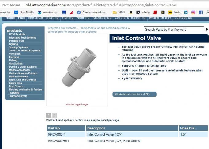

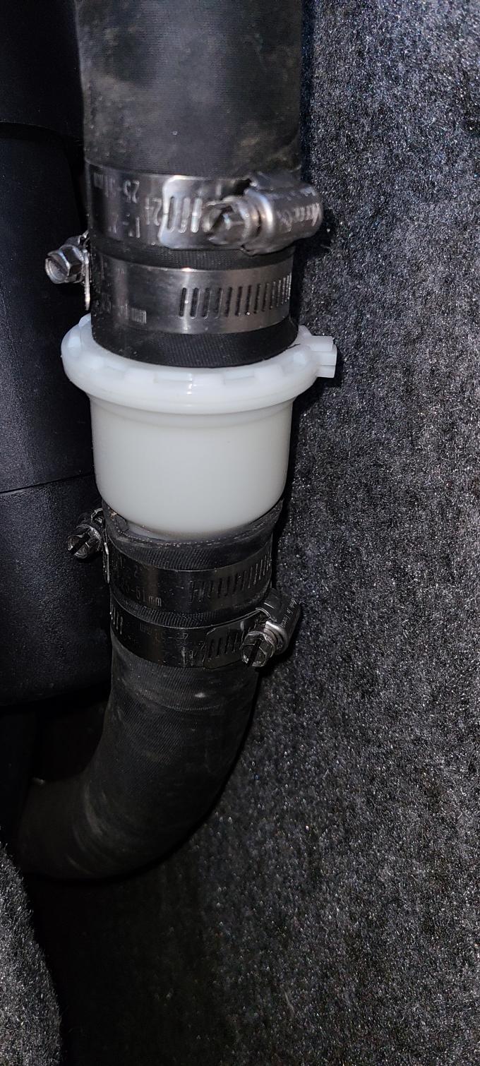

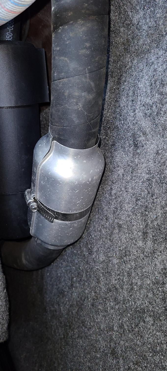

                  I don't think there are carbon cannisters....But they do have these inlet control valves on my 2014 g21. I don't have a problem cause i push/twist my shaker siphon tube past them. But they could be your problem.

                      I had the same issue when fueling my recently purchased 2015 G23 SAN. It took 30 minutes to pump in around 25 gallons at a gas station and had to trickle it in. I emailed customer service at Nautique and they told me to inspect the check valves (located about 8-10" below the fuel cap). I took them both off and they were clean and working properly, problem is that the fuel is not heavy enough to make the spring controlled flap open up. I then took a piece of clean wire and put it down the fill hose to open it up. Put a loop on the end to go over your cap so you don't drop it down and you should be good. You will want the wire to be smooth and kink free so that it does not get caught on the flap when you go to remove. You leave the wire in when filling with fuel and remove when you are done.
                      Works for me every time! Hope this works for all on this post having this issue.
