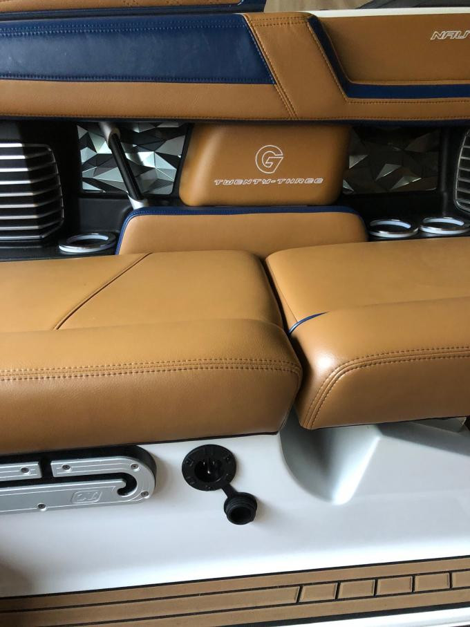

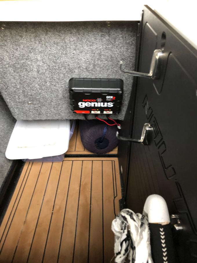

    I just installed the NOCO two bank 8 amp charger in my G23 and I have been pleased thus far. I placed the charger in the port stern locker so it was out of the way and my charging port is midship on the port side. Perfect set up for me.
    https://no.co/genm2
