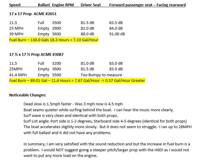

            Here is a summary of the measurements I performed comparing props for my 2018 G23. I shared these results with the engineers at ACME. I can't speak to how prop changes would affect other hulls. But I even measured the hull roll angle while surfing with a precision angle gauge over the transom. The roll angles were identical for both props. And this makes sense. Keep in mind that while greater diameter props will move a greater volume of water for each rotation, when the boat is adjusted to the same speed ANY prop must be exerting the same force on the water or the boat speed would change (F=MA). Since we surf at a constant speed of 11.3 MPH each prop we tested was exerting the same force on the boat at that time. The differences between various props will be changes to top speed, acceleration, fuel burn, and engine rpm (noise levels).
            Boat 2018 G23 H6DI
            Conditions: Sea level. Air temp: 73 degrees. Water temp: 68 degrees.
            Four persons including driver: Two Adults, Two teenagers
            Total people weight 550 lbs. – All sitting on surf side (except driver on Goofy).
            Fuel – Full to 80% for all tests
            Lead ballast – total 900lbs.
            Port side: 400lbs middle seat, 200lbs bow.
            Starboard side: 200lbs middle seat, 100lbs bow.
Name:	Prop Tests.JPG

              I don’t dispute the numbers for your G Gregg , but you aren’t comparing apples to apples here. You’re talking about a 6000lb 102inch beam G23 with a 17/17.5 prop . The hull shape , prop shaft angle , overall weight, and beam of the G boat are nowhere near that of a 210. What happens with a G prop as opposed to a 21ft 210 weighing in at 4000lbs with 14inch diameter prop and only a 98 inch beam is not the same. Further more the wet running surfaces are no where near Identical so you can’t expect the same results.
              I can 100 percent tell you different props can change the wake characteristics on many different boats. On the flip side some hulls don’t experience any change because the difference isn’t significant enough to overcome the variables needed. . Surf wakes are definitely the least effected. Mostly due to the fact people are running so much ballast it tends to negate the Torque factor and running angle difference. So you really don’t experience the prop torque issue too much. I can for sure tell you skiing with my 1617 is different than skiing with my 1579. If I don’t offset the torque a bit with weight the wake is significantly more lobsided. It’s needs less offset at wakeboard speeds , and it needs less at surf speeds. I did lots of testing with Acme back when I was a Ski Centurion Factory Rep, as we were rolling out new hulls every year. Certain hulls experience different changes when swapping props. Certain hulls are more prone to roll as well and need more weight adjustments to have clean wakes. In the surf realm a lot of those aspects are minimized due to the speed and the weight of ballast used. Case in point a 220 vs a 210. Swapping props on a 220 has more of an effect on wakes on the 220 due to the deeper v hull. Companies really have made huge hull advancements in this arena to keep the changes and shifts minimal on the wake sports side.
              You mentioned F/MA . While that is the case, it’s not that simple because your rpm’s will vary on each prop at a fixed speed and the torque value will also change .
              as D
              While in your scenario the you state the force remains a constant.........The radius value is changing with each prop. That will give you a different amount of torque between props if force is kept constant. Clearly the G is such a massive boat it would take a high jump to really overcome that aspect, but as the boats get smaller and lighter the prop has more of an effect with regards to torque . I won’t dive into the 3 blade vs 4 blade wake comparisons , but there is a significant difference in the actual wakes produced by those on numerous wakeboats.

                I'm not comparing my results to anything. I even stated: ". I can't speak to how prop changes would affect other hulls." I simply posted the measurements from my experience.
