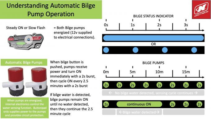

I’m hoping to lean on some shared experiences and help me figure out whether or not I have a problem.
I’ve had the boat for about a year. The front bilge pump cycles regularly as needed and ejects water out of the mid-starboard drain. I realized at some point last summer that there was another water ejection drain on the aft port area of the boat, right next to the port ballast tank overflow, that has never run that I can recall, and realized this is the outflow (I think) for the stern ballast pump. I would always have a considerable amount of water left in the bilge after a day on the water that I would drain by pulling the plug after getting on the lift, and I figured I must have a bad pump. So I replaced it, but still nothing pumps out. When I power up the boat, I feel like I hear that pump cycling though.
Since we’ve not yet gotten into the heart of the summer when we bring the most water on the boat, maybe it just hasn’t filled yet enough to come on, but even since I’ve replaced the pump, I’ve seen enough water in the bilge to at least be covering the bottom inch to two of the pump. I know I may need to troubleshoot with a voltmeter. Any other thoughts? Possible plugged outflow tube? Or does this pump just rarely cycle? I’d appreciate any insight from other 230 owners or those with knowledge of these boats in general. Thanks!
