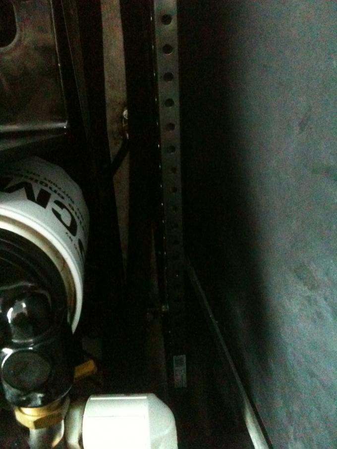

    Anyone have any pictures of a 09 or newer divider reinforcements? Putting 1100’s in my 210 this week and want to get them braced up.

    2008 sante 210
ID:	611295Click image for larger version
ID:	611296Click image for larger version

      Did you cover the hole in the floor where the hard tank drain was?

        Wish my picture was better. I just remember it went from high to low and worked so perfectly. It was stainless square stock perfect length didn't have to cut, holes in right place.
        Didn't cover or cause any problems. Wake makers makes supports. You will see them. I created my solution before wakemakers came out, and I didn't have to attach anything to the dividers at all.

          I used the same u channel steel from a home improvement store. I put 3 across the divider evenly spaced to prevent it from bowing. Did not bolt them to anything else. Sorry, no pictures on me.
