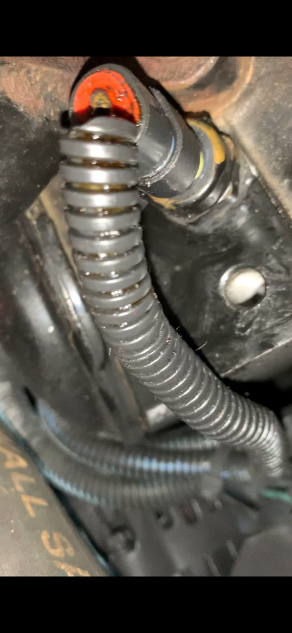

    I did some research today and I believe I located the Knock Sensor on the starboard side of my ZR6 (see pic). If someone could confirm, that would be great. The parts manual says there are two of them on the ZR6, and I looked in the same location of the port side and did not see one.
    Can anyone confirm there are two of them on the ZR6?
    Does anyone know where the other one is located?
    Thanks!
    edit: This looks to be the coolant temp sensor - not the knock sensor.

        Thank you - I believe the sensor I took the above pic of is actually the coolant temp sensor https://www.nautiqueparts.com/produc...ant-temp-6-0l/
        So it looks like I have some disassembly to do. I'm very mechanically inclined (but I have never done this job obviously). Any approx idea how long it should take?
        Also, I have seen other posts where people say they get the alarm when the pull a wakeboarder or put load on the engine. I get it the second I press start (before the engine even starts). That leads me to think that a) the code is stored and needs to be cleared OR b) the sensor isn't connected.
