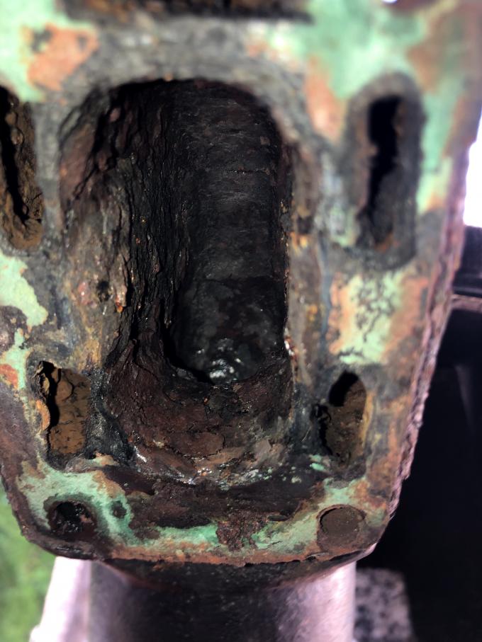

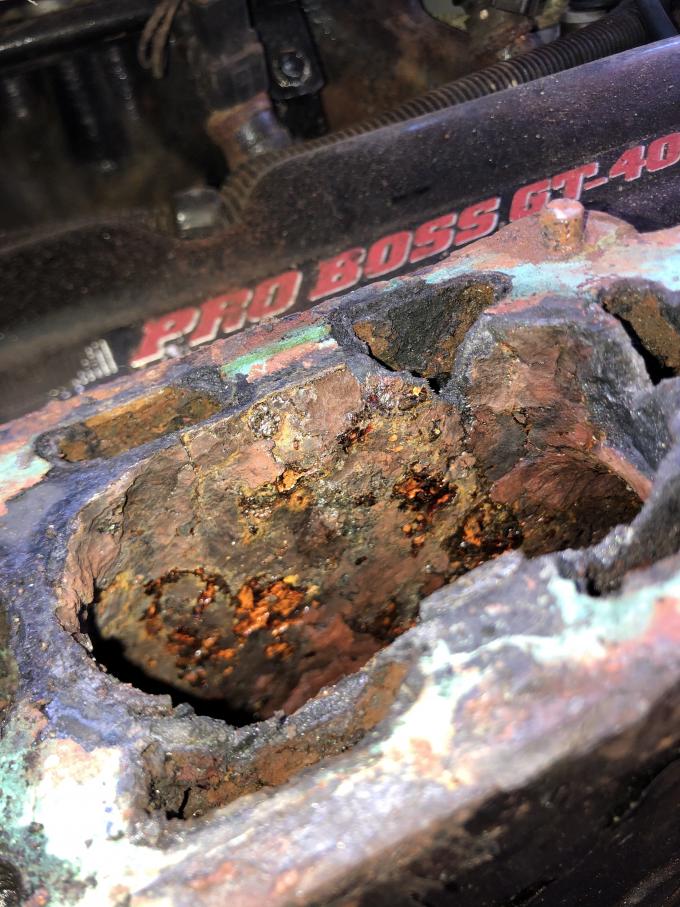

    Alright so I have yet another update. The compression tests came out weird. I would be getting 120ish on one cylinder then test that same cylinder again and get like 60. I think it has to do with my tool not fitting properly in the block. Anyways I couldn't find a leak tester as Harbor Freight was out of stock within 20 miles of me. But I still wanted to just look at the inside of the manifold and riser so I took the riser off and only broke 1 bolt. I have some pictures of just how bad it is below. It appears that the gasket was shot and the manifold and riser. This is because it rotted away and there is an 1/8 inch gap on about 3 of the water holes where the water can just slip through even if there was a good gasket. I am going to go ahead and buy a new manifold and riser plus the gaskets and hardware needed. I am doing this only for the starboard side for now. Thanks to everyone for the help and advice. I will probably be back on this thread when I am done with the installation of new parts.

    • Peter6000
      • May 2017
      • 168
      • northern Virginia
      • 1999 Ski Nautique
      That better than a engine rebuild I would consider replacing them both advatually.
      When the manifault is off take a good look at that valves water intrusion could have created some rust on the valves especially salt water.
      Spinn the motor by hand and make sure the move.
      If you get a leak tester test with the manifault off to monitor the exhaust valves.
      Sent from my SAMSUNG-SM-G870A using Tapatalk

        I fixed the pictures for you.
        Wow, that's pretty bad.
        That's lots of salt water use with very little if any flushing.
        Can't believe you only broke one bolt! Very lucky and very cool!
        I hope the water passages inside the engine are in better shape.

          I couldn't see the pics early that is bad I'm suprised it was still running.

            Thanks for the fix on the pics Jeff. I am also surprised at the fact this thing could run with that much water being allowed inside. The other manifold and riser set will be done this fall.
