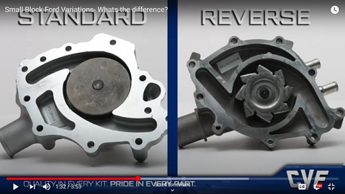

    Have to take it off and look at the vanes. Automotive are just stamped steel the bi direction ones are more of a cast flat dish. Here is a picture of how the different impellers look but these are automotive pumps so pay no attention to the bodies....

      If I pull this pump off how to tell if working or not???
