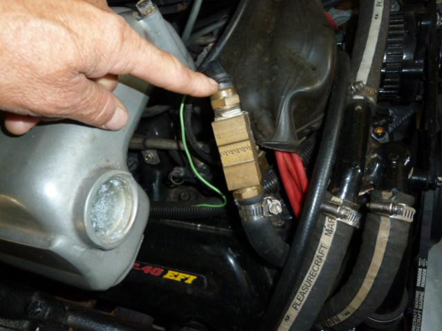

Here's the water temp switch location.
Originally posted by NautiqueJeff View PostHere's the water temp switch location.
Yep, you got it. Look for the green wire.I own and operate Silver Cove Marine, which is an inboard boat restoration, service, and sales facility located in Mooresville, North Carolina. We specializes in Nautiques and Correct Crafts, and also provide general service for Nautiques fifteen years old and older.
