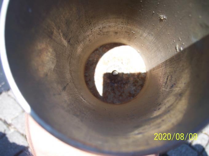

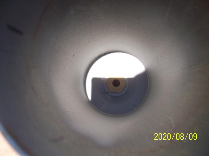

              Originally posted by mpost View Post
              think I will start paying more attention to the FCC drain plug
              Yes... Very hard to take a picture inside the canister but what happens is the water corrodes the canister and when left actually deeply pitts the aluminum,you can see it here on the sides. There is alot on the bottom that's hard to see.
              Click image for larger version  Name:	100_2339.JPG Views:	0 Size:	32.8 KB ID:	620341
              Here is one I bead blasted,again hard to see- need to find a coating like Kreem to seal it back up
              Click image for larger version  Name:	100_2338.JPG Views:	0 Size:	20.4 KB ID:	620342
