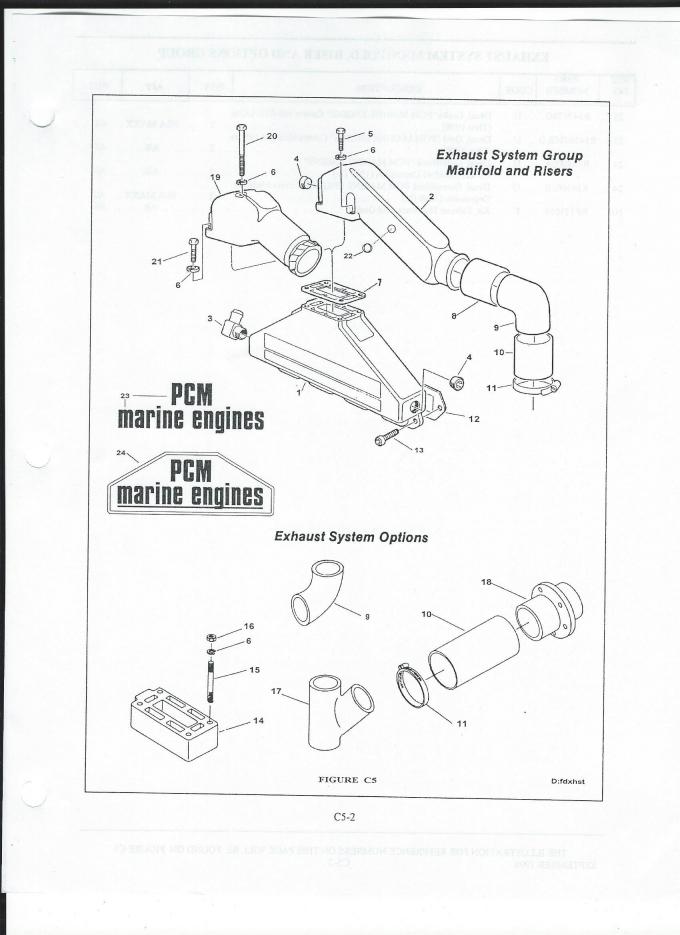

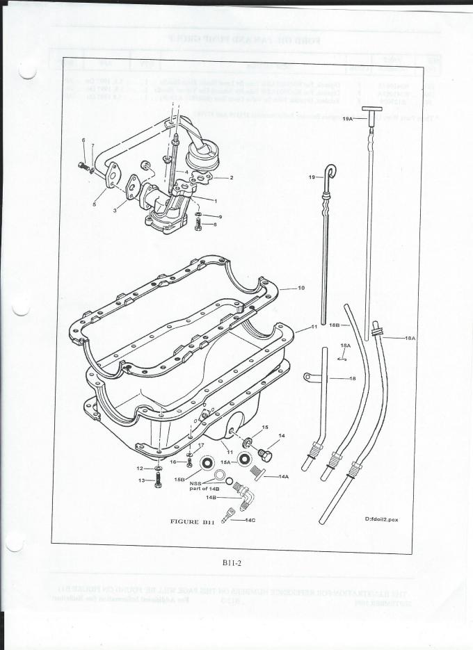

            With out pictures it will be hard to tell what you have,the PO could have done anything. PCM parts book shows nothing except bolts. My 2 GT40's have dipstick tubes like 18B
            Click image for larger version  Name:	PCM dipsticks.jpg Views:	0 Size:	66.7 KB ID:	620449Click image for larger version  Name:	PCM exhaust.jpg Views:	0 Size:	58.5 KB ID:	620450

              My dipstick tube has threads on the end like 18a, but also has a mounting tab like 18

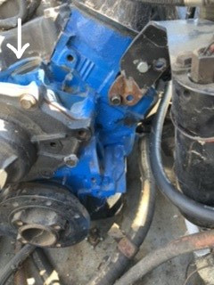

                Here are some pictures of problems areas. I don’t understand why the distributor on this engine doesn’t drop in. It’s like it doesn’t mesh with the oil pump drive shaft or something. There’s is a picture of the distributor hole. Also some
                pictures of how the dip stick mounts to oil pan and where the top of the dipstick ended up, I’m not sure where the bolt hole tab attaches to?
                also some pictures of the fuel filter area as this looked to be modified, possibly due to stripped threads in block or head where this mounts. There is a picture of the water pump area as the hoses and fittings from raw to engine water pump seem rigged, any help on buying the right parts?

                  It sure looks like you have a lot of parts that are not from the original engine. I also suspect that you have a 302 block and not a 351 and that may be why the distributor does not fit. A 351 block is taller therefore a 351 distributor is longer, not to mention that the shaft is a larger diameter -hard to tell from the pictures though. Check out these two pictures below you can see by where the arrows are pointing to the easy way to tell where the differences are.
                  302-
                  Click image for larger version  Name:	302 ford block-2.jpg Views:	0 Size:	17.5 KB ID:	620652
                  351-
                  Click image for larger version  Name:	351 ford block-2.jpg Views:	0 Size:	22.3 KB ID:	620653

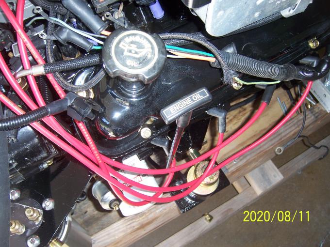

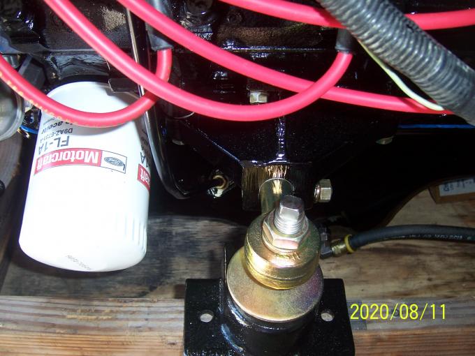

                  Oil pan pictures don't click either. It looks like you have the dipstick mounted into the drain plug area where a drain hose actually goes. The OEM pan has a boss in it on the left side of the adjustable motor mount. Mounting it in the drain hole will make it seem shorter not to mention that the shorter 302 block will change it's position.
                  Click image for larger version  Name:	100_2340.JPG Views:	0 Size:	56.5 KB ID:	620654
                  This is where it ends up on a GT40
                  Click image for larger version  Name:	100_2341.JPG Views:	0 Size:	77.6 KB ID:	620655

                            I've got a 99 air i am restoring right now. I do NOT have a gt-40, just a a base 260hp carbed engine. but i can take pics and show you what mine looked like.
