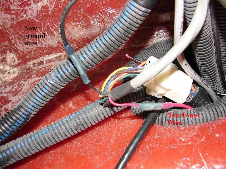

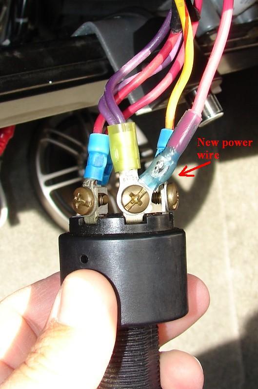

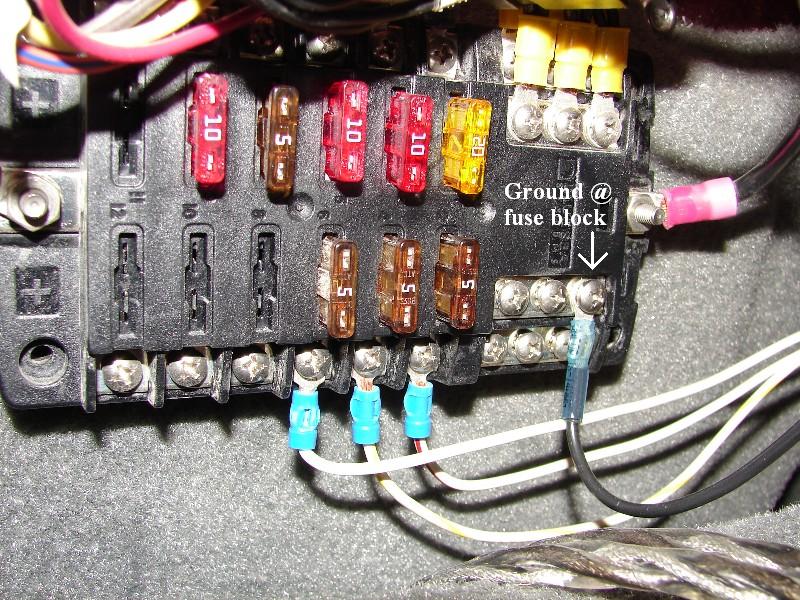

    My boat has a keyed ignition and switches. On the Perfect Pass 9 pin connector that runs to the CC wire harness the red wire is the 12v power wire. PP recommended that I connect it to the purple wire on the switched ignition power and run a new ground to the fuse box.

      Last week I re-wired my PP as suggested by my dealer and PP's tech support. From the 9 pin wiring harness I cut the red (12v) and ran it to the back of the keyed ignition to the purple wire (key on power) and ran the ground to my fuse box.

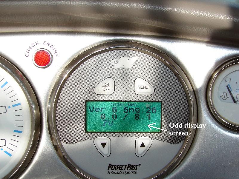

      The system powered up, beeped and the display was backlit but nothing was displayed. I ran the boat for a bit and the PP was controlling the speed but still no display. I started and stopped the boat a few times and reset the PP and the display then started working. It worked fine for a day and then the display stopped working again. Did another reset and it worked for a couple of pulls, then the display went blank and I got the solid beep. I then tried the reset routine again with no success. The whole time when I would check the PP voltage using the "Menu" and the "Up" arrow it would display .7V with no fluctuation.
      I re-ran the power and ground wires directly to the battery to see if maybe there was a voltage issue at my dash and the PP kept doing the same thing...work for a bit and then the display would go blank and I would get the constant beep.

          In addition to the other issues, when the PP was engaged and holding speed, if I turned on any dash accessory, ballast bump, bilge, blower, horn โ€“ the PP would surge the speed 1-2mph and hold. As soon as I turned off the accessory, the speed would settle back in to the set speed.
