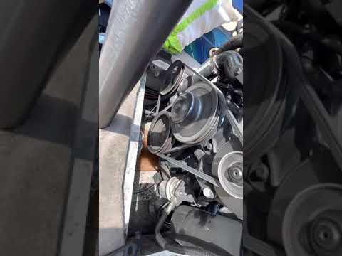

    1. Squeaking from belt pulleys with possible harmonic balancer issue
      1. At idle, squeaking noise coming from pulleys. See link below for a video of it. This is at idle with transmission in neutral. Once throttle is applied it goes away. My biggest concern is the bottom pulley and harmonic balancer appear to be spinning out of round. I can't tell if it is an optical illusion or in fact the issue. There is a bit of belt dust but according to him the belts are original (he bought the boat from the original owner about 6-7 years ago). We've also had a recent low voltage issue (see #4 below).

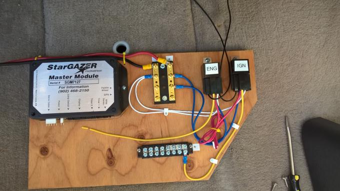

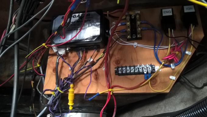

    The Perfect Pass problem is almost for sure power to the dash related. I solved mine by adding an additional harness to the dash with dedicated power and ground. Used to to run the PP and stereo. Here's a couple of pics of what I ended up building and mounting. Dedicated battery and ground lines with relays and busses. This is mounted to airbox above the drivers kickplate....

      1.) my 98 gt-40 had squeaking belts. turned out the pulleys had rust spots on them with built up areas. took some emery cloth to the inside surfaces of all of the pulleys. no more squeaking or belt stretch and burn.

      great idea for re-powering the accessories. as well as these boats are engineered I have found the electrical wiring system to be somewhat lacking.
