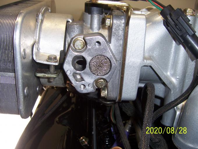

      There is an IAC - Idle Air Control valve located on the throttle body. It controls the amount of Air entering throttle body at idle. Its common for them to fail, or get dirty and act up.
      A good cleaning, including a the little air screen that should be in there (if I recall).
      Its a relatively easy job and worth a shot.

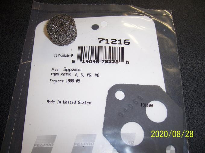

            ECT, F2AZ-12A648-A ACT, F2DZ-12A697-A IAC, E9SZ-9F715 these parts also have aftermarket alternatives which should cross reference. I would follow windsurfnut's number 3 post above-there is a thick screen which you could check and clean with carb cleaner after you remove it. Also a picture of Felpro's part number for a gasket.
