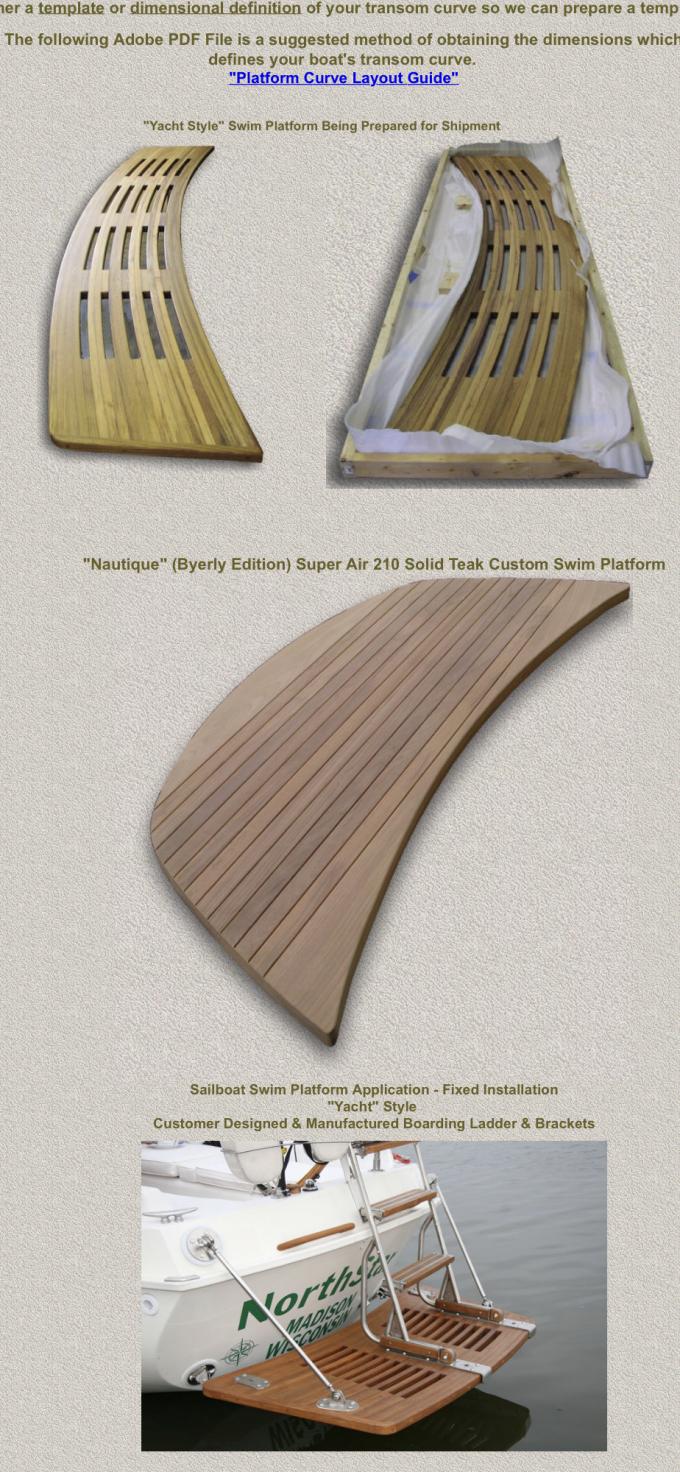

              http://www.teakmarinewoodwork.com/sw..._platforms.htm
              You could have one custom made for your boat any size you need if it came down to it.
