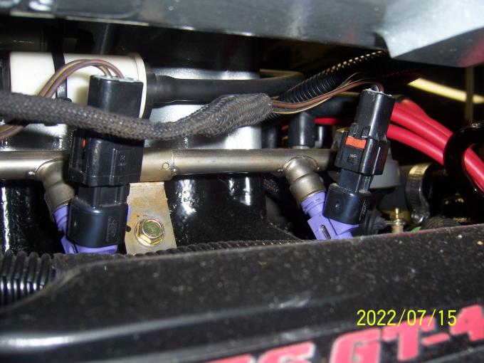

      Here are Ford branded ones newest design These work great- https://www.summitracing.com/parts/fms-m-9593-lu24a
      You will need these type of adapters too, EV-1 to EV-6 like these- https://www.summitracing.com/parts/btc-ev1ev68
      Here they are installed with the adapters- new style injectors use a different plug so the adapters make it plug and play without any cutting of wires.
