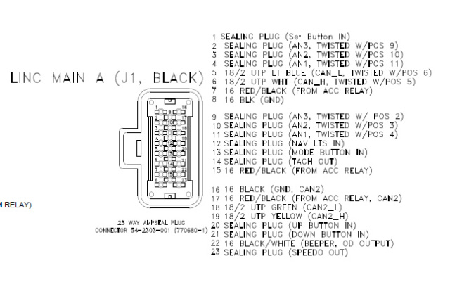

        Almost certainly a power issue with both the stereo and Linc not working. If the fuse isn't the issue, disconnect the black 23 pin connector from the back of the Linc and use to meter to see if you have power betweens pins 7 and 8. The attached diagram is looking at the connector on the back of the Linc, you need to measure those pins in the plug for power, so you'll have to do the orientation translation. Looking in the plug, it'll be the bottom 2 pins on the right.
        If you don't have power at those 2 pins with everything turned on, then you'll have to start tracing back to see when the problem is. Finding a wiring diagram for your boat would be very helpful.
        There should also be power between pins 15 and 8. Pin 15 is the "ignition on" signal to the Linc display.

                No power on the the black 23 pin connector from the back of the Linc between pins 7 and 8. And also no power on the stereo amps.Click image for larger version
