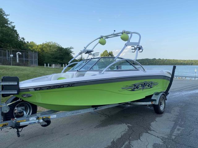

    So we finally got a slip at our local marina but there is no lift yet and may be a while before one comes available. I don't want to leave her in the water but think we're going to try it. After poking around it seems that most problems arise from gelcoat blisters that form, however, I haven't gotten an answer yet on the bilge pump question.
    Will it need to have water pumped out while sitting there? If so, is my bilge pump wired so that the master battery switch won't disable it? How do I check? 2005 SV211 for reference

      While on the trailer tilt the boat so water pools near the bilge pump. Turn off the master switch and add water into the bilge with a garden hose. If the bilge pump switches on you have a definite answer. Don't trust anyone or anything else. Here's how it could turn out if you are wrong.

                  Do you have one of these ALL ON / ALL OFF / BILGE PUMP ON switches? My '07 SV211 does. If so, put the switch to BILGE PUMP ON and pour some water into the bilge to test it.
