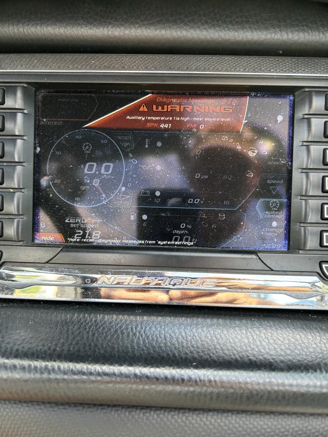

    I was just testing my boat by starting it in the lake today and got this message. Auxiliary Temperature 1 is High - most severe level. I was running it on the trailer at idle watching for the thermostat to cycle. The temperature just passed 152 when the message popped up. My boat is a 2014 G21 with zr409. Can anyone offer any information and direction. Thanks

    The code I beleive is indicating a fault condition with the exhaust manifold water temperature. There is a sensor in each exhaust manifold. May be a bad sensor or 101 other reasons. When you say you were running the boat on the trailer, we be assuming that the boat was in the water, sorry I had to ask.

      I found my problem. I’m not believing I’m saying this. I had a hose off I missed when recommissioning. It was at the transmission cooler. Guess that’s a good reason to check everything out before everyone is here. Thanks for your help.
