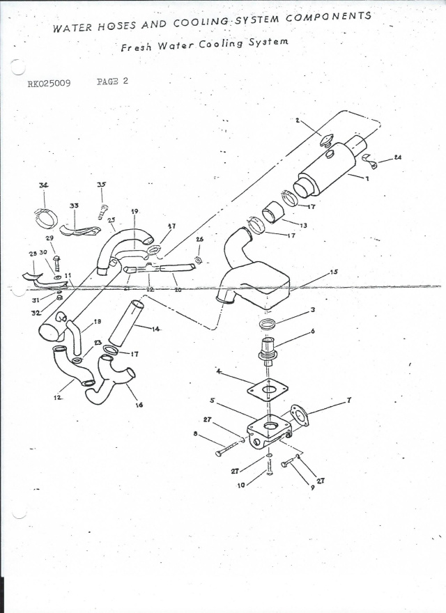

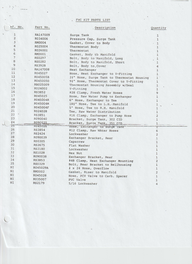

        Should all be 1" hose and a 1" T just like a original raw water cooled boat . Unless they used a larger 90 on the manifold ends and a different larger outlet heat exchanger. Unfortunately the original instructions don't state hose size because they were all included in the conversion kit
        Click image for larger version  Name:	fwc parts list 001.jpg Views:	0 Size:	195.5 KB ID:	673230

          Your going to have to change them anyway- I'd take them off to confirm outlet size on the exchanger and 90 size on the exhaust manifolds
