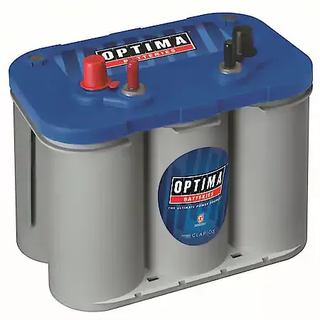

            dhanni848 Let's start the battery wars to create some excitement as we approach the Memorial Day weekend. I replaced my 2 batteries in my 2017 G-23 with 2 Optima Marine AGM batteries with 750 CCA size 24 M. I could not be happier. I have had no problems in the last 3 years of using them.

              I'll give you a second 5 stars there GMLIII. Super spendy buggers, but you are never left worrying about your batteries.
              You just have to keep them charged in the winter, they don't like 1/2 empty. I had one replaced after 2 seasons, had a elec. drain in the boat and spaced the charging etiquette. They replaced it under warranty at no cost.
              Running 4 subs at 120 decibels half the day chillin' in the bay, no worries.
