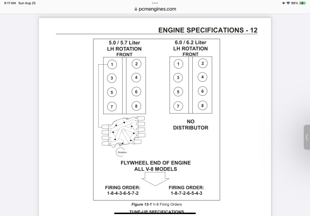

    Bank 2 is the side with cylinders 2-4-6-8.
    Right side of engine, port side of boat.
    Pretty sure this is where we started, best of luck, let us know how it works out.

ID:	679861This is the relevant info

        Swapped it out today. So far so good
