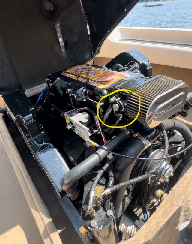

    Looking for someone with the original python (8.2L). I believe this was '99 and '00 to take a photo of the throttle position sensor.
    Starboard side of engine if direct drive, right below the idle air control valve.
    Just trying to verify how it should look. Photos of mine below showing location and photo head on to see your part.
    Located here:

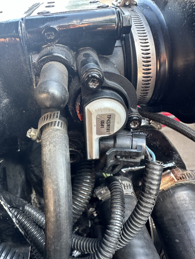

    Looking for a photo like this

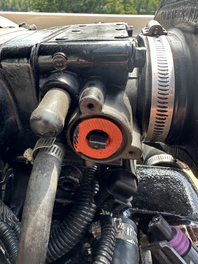

    Photo showing TPS removed

      Originally posted by s_kelley2000 View Post
      I can get you some pics of my Super Sport this week. I replaced the TPS on mine a couple years back and it totally cleaned up a rough idle I was experiencing in case that is something you are chasing.
      That would be great. I'm question how it leaves the leftside of the circle gap'd.
      Yes chasing rough idle/stalling when put into gear. Really only happens after engine has been warmed up. So after a few skiers it starts stalling when put into gear. You have to bump the throttle to keep it running.
      So far has replaced:
      Spark Plugs
      Cap
      Rotor
      IAC
      TPS and fresh fuel filter going in this weekend.
