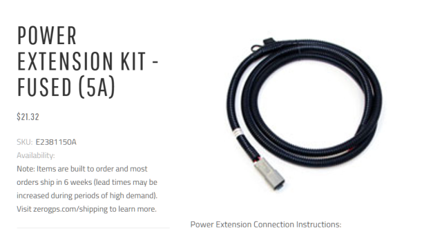

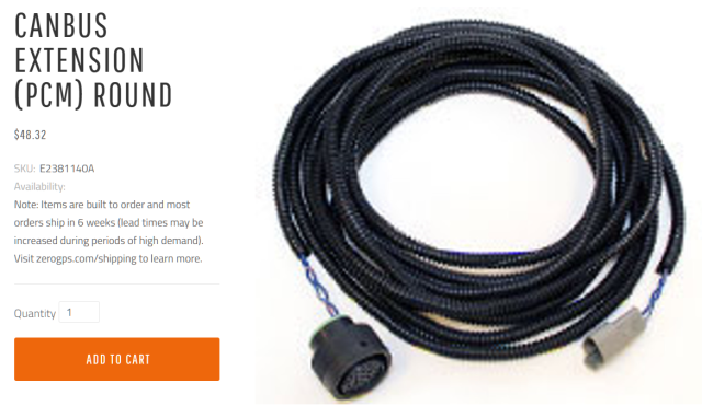

    I bought from Grealaskipper a Zero off Kit that came with the brain, the cable and two garmin 18x antennas. I ordered a PCM BUS cable and power extension cable from Zero off. Now, I see that there a videos where they update the zero off with a Ecom cable. Great lake says that it is not necessary and Zero off never replied to my email.
    My question is : Is the zero off plug and play for my boat or do I need to do some sort of programming to the boat engine ECU or anything like that ?

                      You don't need any of those other cables that your bought.
                      So the base kit you bought should be plug and play without any additional parts. Worse case you'll need to swap in the new cable to add the GPS puck connectors if they aren't already there. Besides that, you'll just need to deal with getting the puck firmware updated and the pucks reconfigured. I'll respond to your PM about that.
