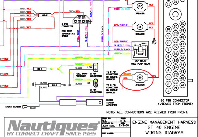

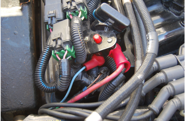

          IDK if this breaker was still on the engine in 2001 but I've had this breaker bite me a couple times. This breaker is typically mounted on the engine and typically has a red button on it. If it pops nothing works. Should be a quick thing to check....
