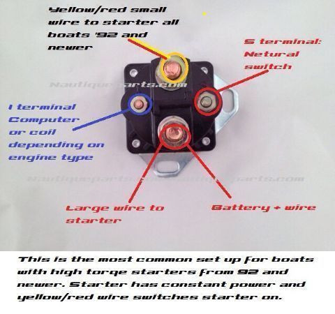

                          #27

                            #28
                            Here is another interesting failure mode (if you can call eating a $250 starter interesting)...
                            I had a problem with my 2001 a couple years ago where you'd hit the start button and all you'd get is a click. This was on a Sunday. After a little troubleshooting I determined the starter relay pictured above to be the culprit. The only thing open on Sunday around here was an O'Reilly's so I bought a relay that was same form/fit/function, but pretty generic looking and probably made in China.
                            Fast forward to a couple weeks ago. Wife and I are out after a couple cocktails and I'm running the boat up and down the lake at WOT. Were going to sit for a bit and hit the stop button. Engine kept running but dash went dead. Uh oh. Opened the doghouse and it smelled like a giant electrical fire. Got the boat on the lift and it died before I needed to run and grab a wrench to yank the battery cable. It was running pretty rough but couldn't figure out how to shut it off.
                            Diagnose bad starter, and replace it to the tune of $250 (yes I know you can buy them online for $131, but it was a Saturday and a boat dealer 5 miles from me had it in stock). Replace it, all is good. About a week later my ski partner and I just finish our two sets and we get ready to head back to the dock when I hear what sounds like the blower running. Turns out the starter was still engaged! Limped it back to the lift at idle, and same thing, wouldn't shut off.
                            So I figured either the ring gear was screwed and holding onto the starter, or something else. Well the boat not turning off with the dash or even the lanyard was the clue I needed. I looked at the schematics and determined it had to be the starter relay sticking on, as that would keep the boat running and keep the starter engaged. Replace it this time with a good NAPA brand (Echlin) one, which looked like much better build quality.
                            But if you ever have the boat not shut off when you hit stop or turn the key off, it's this relay, and the starter is still engaged more than likely. Do not run the boat at RPM. It was dumb luck that it happened to me when I was idling back to the dock. My guess is that a gear reduction starter is at least spinning 20x the speed of the engine. That means at 3500 RPM it's spinning at 70K RPM!!! No wonder the old one cooked.
