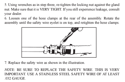

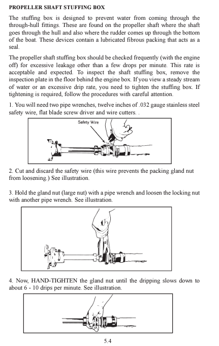

                  Kennydt If your 2002 has never had the packing around the shaft or rudder adjusted, it is definitely time. Both require periodic adjustment, as outlined in the manual. If they are tightened fully and still leak, it is time to replace the packing material.
                  From the 2002 manual:
                  Click image for larger version  Name:	image.png Views:	0 Size:	105.5 KB ID:	682287
                  Click image for larger version  Name:	image.png Views:	0 Size:	43.8 KB ID:	682288
                  The rudder will have a similar configuration.
