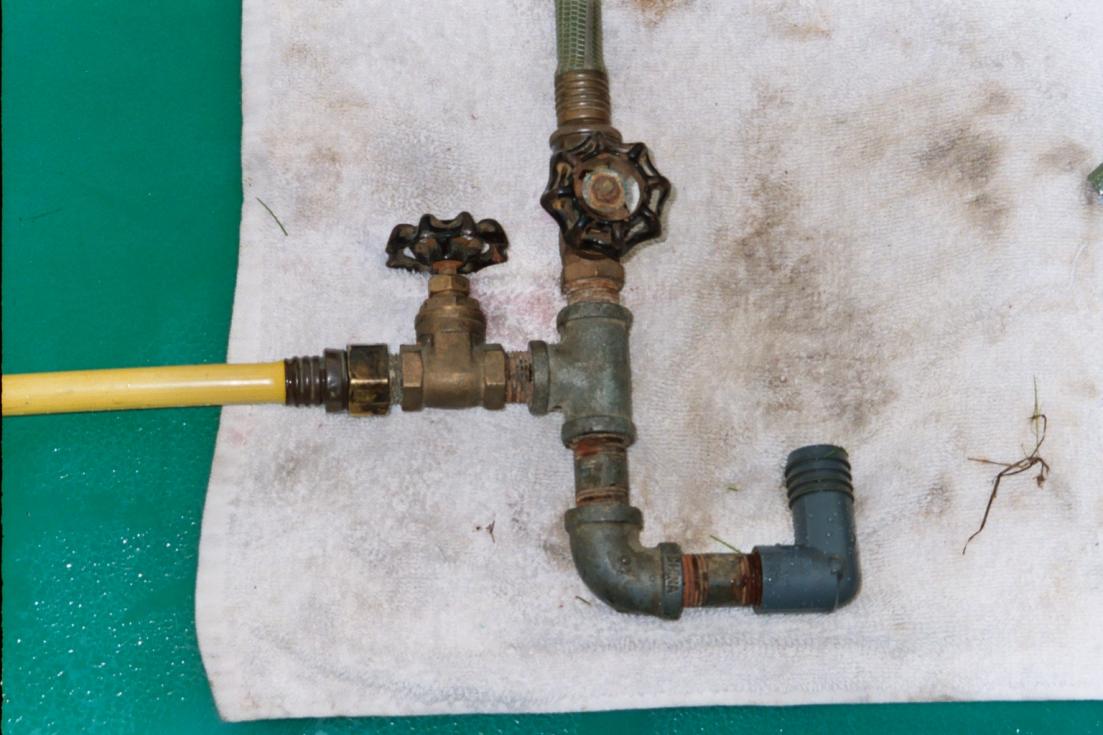

    This is the flushing adapter I made.
    The yellow hose goes to the water supply. The hose at the top of the picture goes to a bucket. The gray 90 degree nipple goes to the boat.

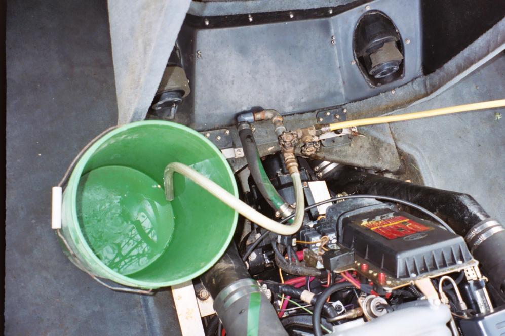

    This is the flushing adapter hooked up to the boat.
    • DanielC
      • Nov 2005
      • 2669
      • West Linn OR
      • 1997 Ski Nautique
      To use the adapter, get a hose long enough to go from a water faucet to the adapter in the boat. Hook them up to each other. Turn on the water supply at the faucet, and turn on the hose valve on the adapter, to bleed the air out of the adapter. Turn off the hose valve on the adapter. Hook the adapter up to your boat, the picture is a direct drive boat. Put the short hose in the five gallon bucket, and turn the bucket valve on. Slowly turn on the hose valve, the bucket should start filling with water. When some water gets into the bucket, start the boat. With the boat at idle, the bucket will slowly fill or drain, depending on your boat. At my house, a GT-40 engine, with a good raw water pump, will very slowly fill the bucket at idle, and off idle the bucket will start to drain. If the bucket is full, it will drain the bucket in less than a minute, with the water supply shut off.
      I can use the adapter in three ways. As explained above, just to run the boat.
      I can also run the boat with the bucket filled with anti freeze and the hose supply shut off, to suck antifreeze into the engine.
      I can stop the boat engine, and turn off the bucket valve, and open the supply valve. This will pressurize the suction side of the raw water pump, and you can look for leaks, that would draw air into the cooling system.
