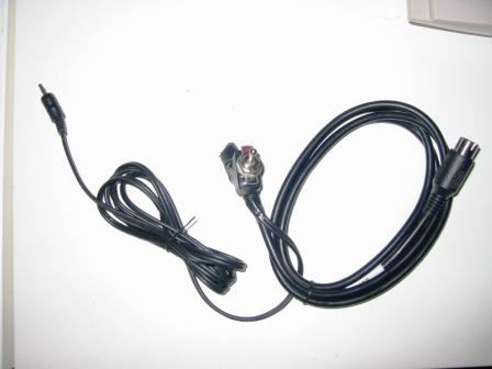

                    Adapter
                    Just finished mine. I have to wait a few weeks to see if it works!

                      #85
                      I just finished my project and it DID NOT work. UGGGH! On the first page of this thread that shows the schematic, I should look at it from the view where I would make my solder connections correct???? My switch is hooked up to pins 5 and 9. When I go to throw the switch however nothing happens. I even tried to look at the schematic in reverse and the radio immediately went dead. To get the radio to work again I would have to turn my switch off and turn the boat back off and on again. My radio is an XMD1. Any help is appreciated.

                        #86
                        The schematic shows a MALE plug. Thats what an earlier post states. That is the way I wired mine. Don't know if it works though. If you made your solder connections via the schematic then your connections are all wrong. I bought the wired cable and had to test every wire to lable. I tripled checked before I soldered my connections. But.... have not been able to try it yet.

                          #87
                          I found that if that you can use a pair of needle nose pliers to pull each pin out as needed and then simply push them in. Does the schematic show the back side view of the male plug since this is how I wired it and it did nothing. I reversed it and it killed the radio and had to "reboot" the boat with the switched turned off.

                            #88
                            According to FLUX. Schematic Shows the side that plugs into radio, the side with the actual pins, not the solder point side.
