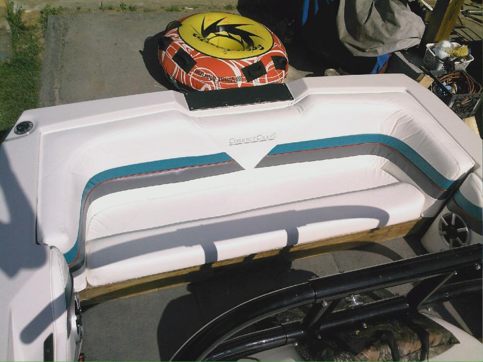

Nice job, can't wait to see the finished product!

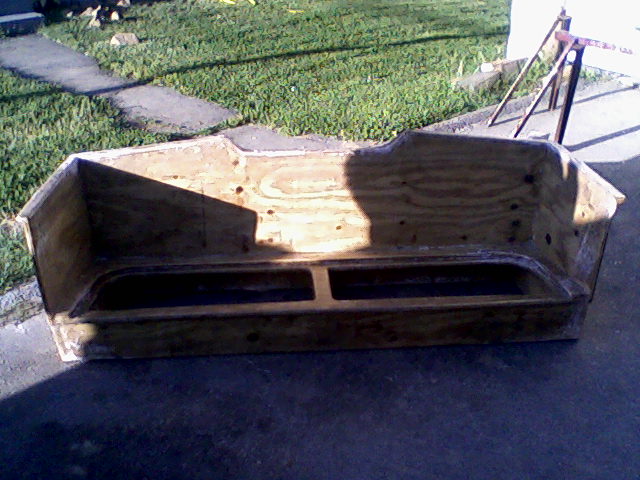

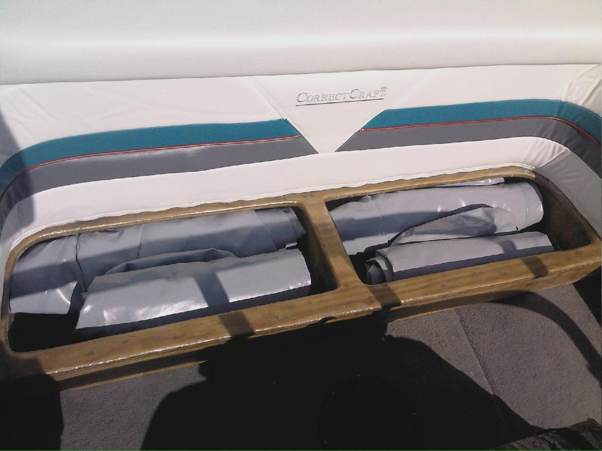

Originally posted by bobchrisCPES will not soak in to pressure treated wood unless you let it weather for a couple years. big mistake using it in the first place, can't fibergalss to it, can't seal it with CPES, paid twice as much for it not a very good choice of materials IMHO.
Standard plywood and CPES from the rot doctor is the only way to go when dealing with decking or seating structures..... now there is better stuff to use but it comes at a premium too so you have to plan on keeping the boat for very long times as in forever.
Not a big mistake, it took me 6 months of looking before I figured out not to use pressure treated lumber when replacing a floor in my old boat. Good thing I spent a year figuring out what to do before I started doing it. The pressure treated lumber should last plenty long if you be sure that it doesn't sit around wet all the time, so be sure and flip your seat bases up when you put the boat up, and put some damp rid or something in there in the winter.
If you haven't already tried to put some fiberglass on it, you might want to hold off on that. I heard many debates about whether or not that will cause pressure treated lumber to rot faster because it never dries out after the treatment. I don't have 10 years to test this theory so I figured it was best to go the exterior lumber and epoxy route. Laminating epoxy and xylene make homemade CPES, and you still have time to try it out on the seat bottom, which will be the most likely thing to rot first.
I say don't sweat it. By the time that seat would rot, you'll have gotten your time and money out it. You built the first, so you can build another. Slap some upholstery on there and go enjoy your boat. BKH2001 Super Air
Originally posted by bkhallpassI say don't sweat it. By the time that seat would rot, you'll have gotten your time and money out it. You built the first, so you can build another. Slap some upholstery on there and go enjoy your boat. BKH
I'll also vote for the don't bother epoxying it and just run it. If it can't breathe and dry out it will rot. Half of it will be wrapped in vinyl and now you know resin coated exterior ply would have been the better choice, but this will work for XX years anyway.
On our old pontoon boat, the floor (pressure treated ply) lasted longer after we stopped covering the boat.
its done
Originally posted by jasonwm View PostNice job, can't wait to see the finished product!Last edited by 93nautique0710; 05-10-2010, 06:42 PM.
