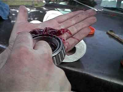

    Sadly this article has quite a few issues with it. Some plain wrong.
    - Nailing hammer: Never use a nailing hammer. The surface of this type of hammer is very brittle and if you use it to strike a steel punch for example, it can cause a piece of the hammer to fracture off at high speed and possibly embed in your body. ( A screwdriver was used here with a plastic end which would not fracture the hammer head)
    - A screwdriver is the wrong tool for this. Use a round steel punch with a machinists hammer.
    - The method shown to pre-lube the bearings is WRONG. This does not pack grease into the critical areas. You put grease in your palm, hold the bearing at a 45 degree angle to your palm, with the wide end of the bearing facing your palm and press grease between the inner and outer race until the grease emerges from the other end. Rotate the bearing to do this to the next section of the bearing. When grease readily emerges from the other end at all points your done.

        That's because the bearing buddy WILL force grease between the bearings in operation. My point is that the initial packing method was wrong.

            You are spot on with the hammer. It is very common to grab the nearest hammer and start beating on whatever you are working on. I have to remind myself of this on a regular basis. As for the greasing, I don't see the problem with what he is doing. The key is to get the bearing packed...are you concerned that his method may coat the exterior of the bearings, giving the illusion of a packed bearing, while leaving the inside dry?
                  Yes, this is the issue. Putting grease on the outside will not result in grease making it's way to the inside where 46% of the bearing surface resides.

                      Bearing packers are messy and leave grease all over the packer which must be removed. Get latex/nitrile gloves... Put a big glob of grease (the proper grease) in your palm, cup your palm slightly. Hold the large end of the bearing at a 45 degree angle to your palm, press the bearing into the grease in your palm until it emerges from the small end of the bearing. Rotate the bearing about 22 degrees and repeat until grease protrudes from the small end of the bearing all the way around the bearing. Coat the outside of the bearing with a thick coating of grease. Coat the race with a thick coat of grease. Assemble.
