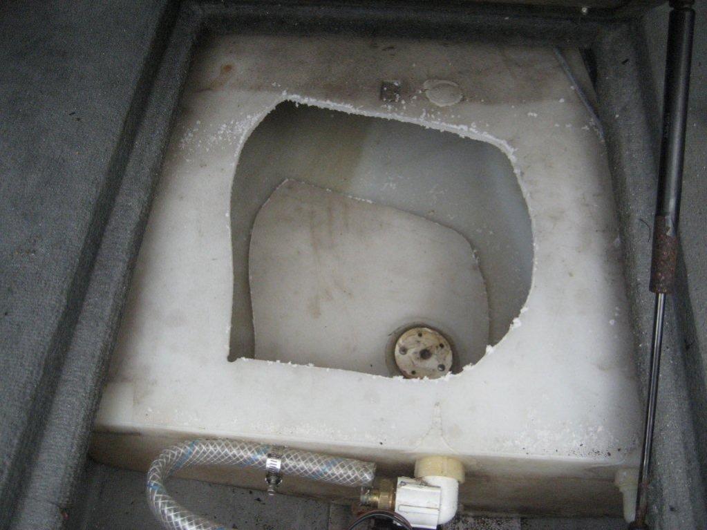

    Hey all,
    I decided to remove the center ballast tank from my 2002 SANTE, and since I was going to scrap it altogether, I figured cutting it out would be easier than removing the gas tank, floor, etc.
    Overall, the removal took approximately 2 hours.
    The primary tools I used to cut the tank out were a Dremel Multi-Max tool, a jig saw, a chisel and hammer.

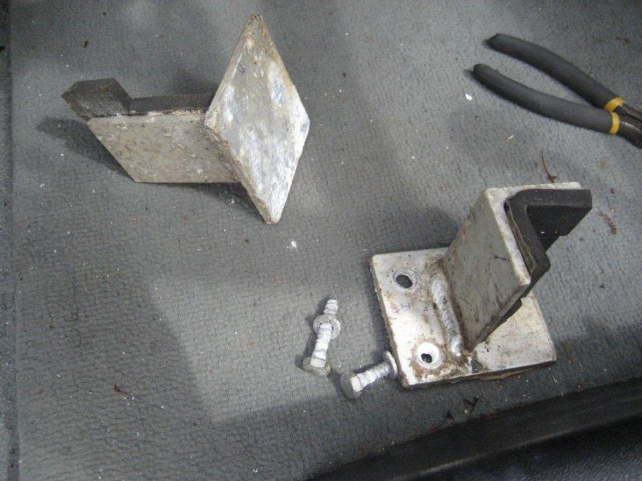

    The first step is to remove the brackets holding the tank in place
  • intrlaz
    • Aug 2009
    • 230
    Next, I slid the tank toward the stern and cut a large hole in the top with a jigsaw.
    Generally, the jig saw would be my choice of tool if it weren't for the lack of accessibility. It makes short work of the plastic and doesnt leave a huge mess
    • intrlaz
      • Aug 2009
      • 230

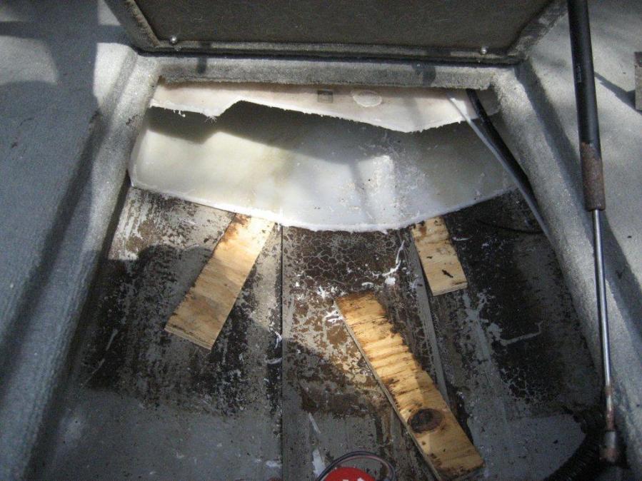

      Because the tank is installed below the floor, I had to cut out half at a time. Through the entire process, I made 5-6 cuts (excluding top cuts with the jig saw)
      This picture shows the result of my first cut.
      For the long cuts on the bottom of the tank, I used the semi-circular blade on the Multi-Max. I also shoved some small pieces of plywood under the tank to make sure I didn't damage the hull.
      The semi-circle blade does no work very well in corners, so I used the flat blade and the chisel for these areas. Do not underestimate a well sharpened chisel. It easily sliced through the plastic.
      • intrlaz
        • Aug 2009
        • 230
        I had to be more careful on the starboard side because hoses and wires are run past the tank. To avoid any issues (and it actually made the cut easier), I reached out a bit to cut around the difficult areas.
        • intrlaz
          • Aug 2009
          • 230
          After each piece is removed, I continued to slide the tank back toward the stern. Eventually I got to a point where I could maneuver it out of the ski locker.

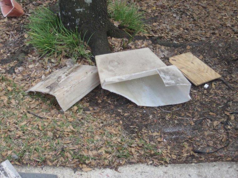

            another

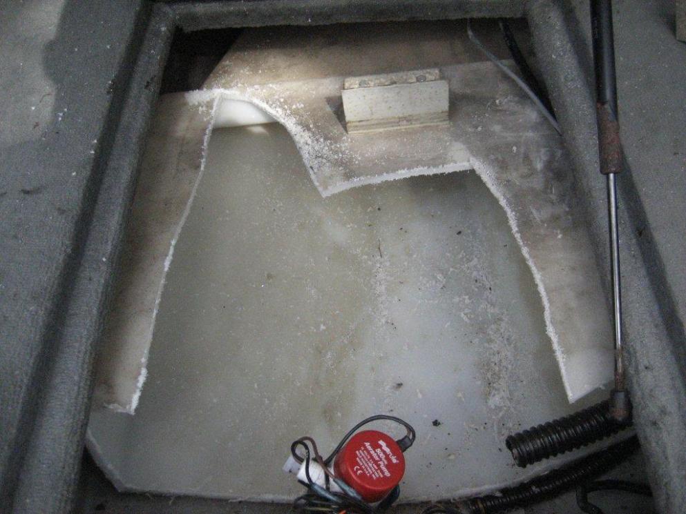

              Reassembled

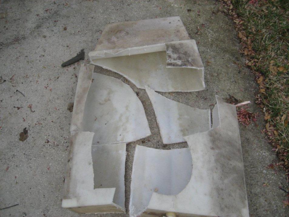

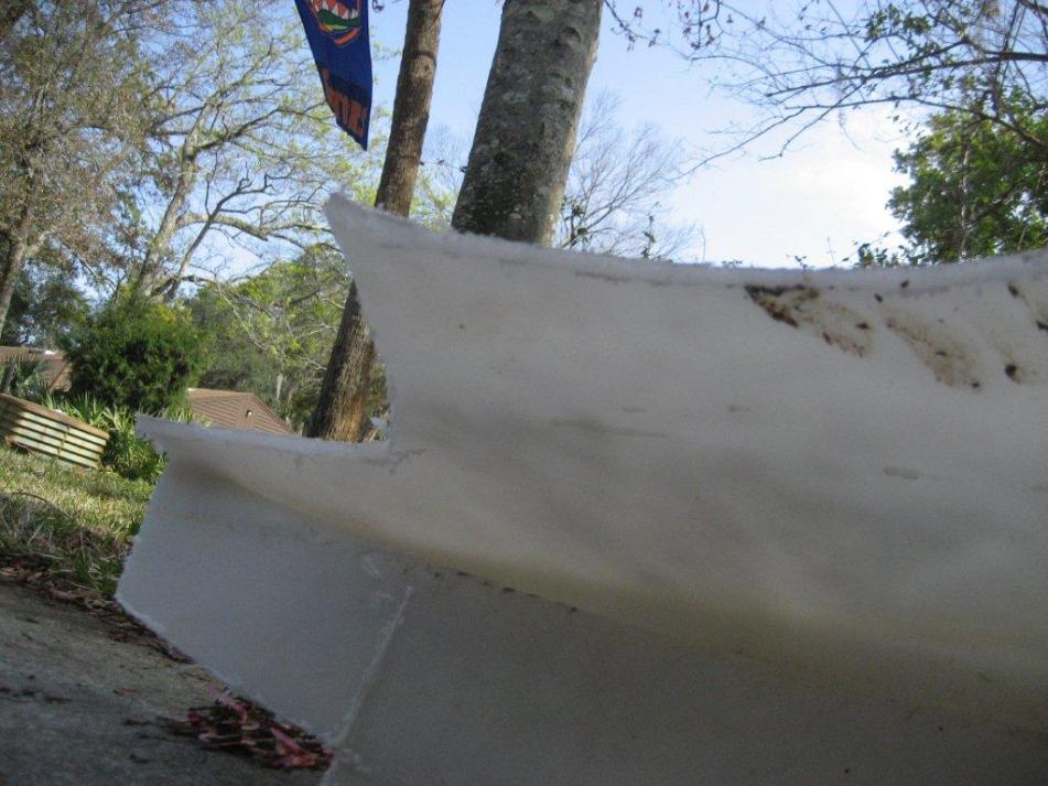

                Just to clarify a couple of points.
                The after cutting the hole in the top of the tank, I started with cutting a section out of the port side (as seen in the last pic I posted, this is the bottom left section).
                The second cut (starboard side opposite of cut 1) is probably the most difficult. If you look inside the tank, you can see area of the rear, starboard side area of the tank is very contoured and would be nearly impossible to get a cutting tool in there. Even if you could, it would be very easy to damage the hoses and wiring behind.
                This is why it is easier to reach out further toward the bow and cut around all of this junk. It can be tight, but doing so will save you the hassle of cutting through the contours. See the fourth picture I posted. It is a bit hard to tell since the section is already removed, but you can see how I did not cut straight across and instead reached out.
                On another note, I realized before beginning the process that even if I did remove the floor and the gas tank (no small feat), I would still have had to remove the center ballast pump thru-hull (which obviously would have required reinstallation). Just another reason why I am happy with cutting it out.
