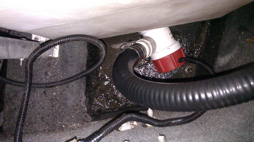

On a 2004 SANTE the empty pumps for the rear hard tanks are physically attached to the bottom of the tanks and hang down into a cut-out near the transom. After wrestling the factory hoses off the tank and lifting the tank to access the pump I realize the replacement pump is several inches longer than the stock pump. So I attach the new pump and try to drop the tank into place, at which point I realize the tank will not go back into place. The new longer pump is wedged up against the inner edge of the cut-out it drops into, and the brackets that hold the tank in place will no longer fit. This means that the only thing keeping the tank, and 260 lbs of watter, from sliding to the middle of the boat is the plastic pump housing. Not good.
If you look near the top in the first picture at the bracket comming off the tank you can see how far to the left the tank is wedged, how the bracket doesn't reach the up-right. And if you look to the bottom of the second pic you can see the red top of the pump wedged up against the edge of the cut-out.
So after a little time thinking I head up to Low's and pick up a 3/4" 90 deg male to female connector.
And I re-attach the pump angled to the back outside of the boat.
Then I drop the tank back into place, a perfect fit, both the brackets that hold the tank in place fit just like before.
I think you could get away with a 45 deg connector if you could find one.
