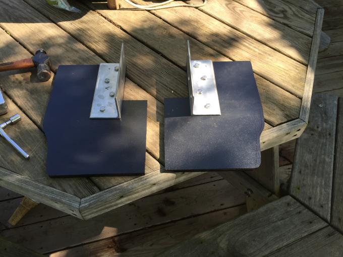

                              I built some surf tabs this past weekend and tried them out. I am completely a beginner at the whole surfing thing and quite honestly no clue what I'm doing, but want to get my '96 super sport surf able on port side. My tab sticks out about 2" on side and 1.5 on bottom. I have 2 750s in rear locker and 1 370 in ski locker. I had everything full except was only about 3/4 full on starboard locker. This was my first time trying to surf but I don't feel like I had a big enough wake. Think I need to make tabs slightly bigger and need more weight in front. I pretty well copied these guys idea. Don't have pictures of brackets mounted to boat because my runners on trailer stick out to far to test fit. I used jangelides method though with 4" angle behind swim platform bracket.

                                Thanks for the ideas I had a crack at it today
