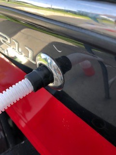

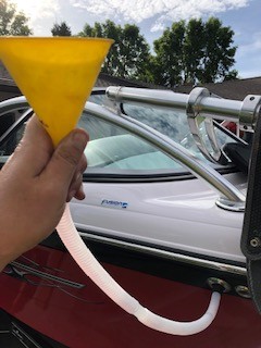

    I came up with an easy way to get marine antifreeze into the ballast tank vents without having to unscrew the hoses or pump in with a fake a lake. This is especially nice for the belly tank. The vent hoses or the rear tanks are easy enough to unscrew and to pour antifreeze into but the belly tank would be pretty hard to get to and the vent points down so its hard to get a hose shoved far enough into the vent hole and not have it come pouring back out your vents. I installed a new dishwasher in my house recently and didn't need the new hose. I had it laying around my garage and found that the rubber end fit perfectly into the vent hole of my SV 211. It was a perfect seal. So as long as my funnel was above the level of the vent the antifreeze would pour right into the tank through the hose. I put about 2 gallons through each tank and pump. I could catch most of the antifreeze from the intake under the boat into a bucket when I pumped it out of the tank. It worked really good.

    Wouldn't your technique work just as well for the 2 rear tanks as you used for the belly tank vs unscrewing rear vent hoses? Looks to be a great idea.

      I used it for the rear tanks also.
