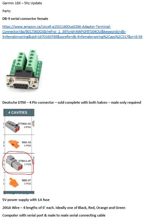

    I did this last year and thought I'd share. This applies to the dual puck Zero Off system - on boats produced before 2018. Sometime around 2018 there was a change in how GPS satelites transmitted their date (I believe this is the issue). The old GPS pucks need to be updated to communicate properely with the GPS satelites.
    I was having the following issues:
    - low satelites - 3 or 4
    - rarely getting diff lock
    - after the boat sat for awhile without running, Zero Off might not work or it would be flaky
    - likely the pull was subpar but this is speculation
    There are two options to fix this - 1. Update the GPS puck firmware or 2. Update to a single puck. Since updating the firmware is almost free, I elected to go this route.
    See the attached file for instructions on how to update.
    After doing this, ZeroOff went back to working flawlessly - always 9+ satelites, always diff lock and it doesn't matter if the boat sits for awhile.

        Looks like the attachment is not working so I'll try pictures of the document
        Click image for larger version  Name:	pg1.jpg Views:	0 Size:	89.9 KB ID:	683319
        Zero Off Puck update
